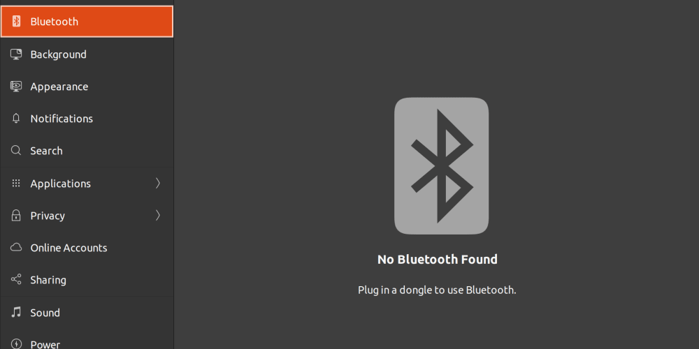

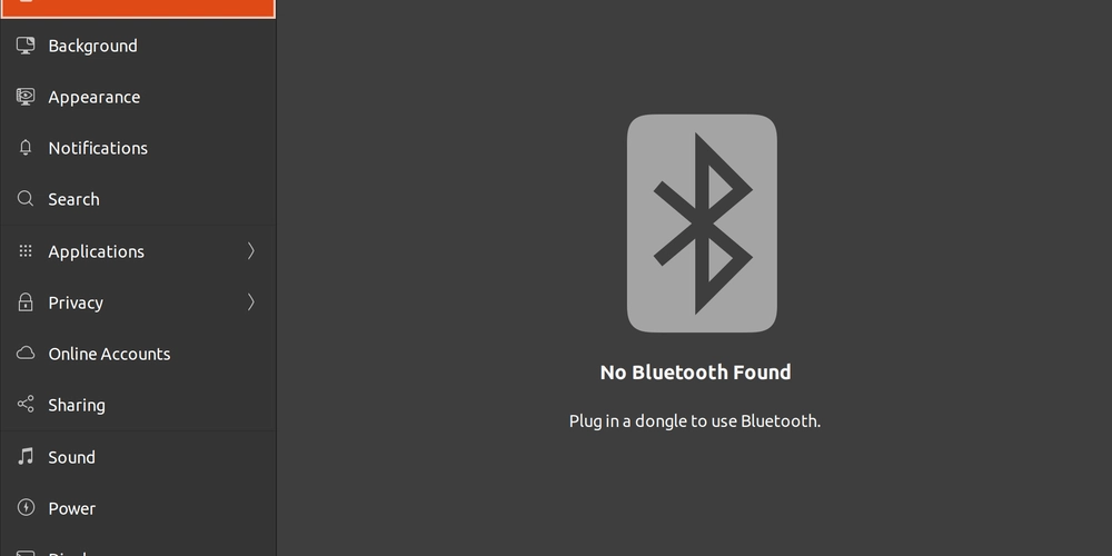

In the meantime - any ideas what might be causing my bluetooth not to work? I can apparently ‘switch it on’, but it basically stays off.

As it comes to your BlueTooth, before you go on ahead to a link I had a glimpse at, please make sure to install and run TimeShift. This is like macOS’ Time Machine or Windows’ Restore Point. Once you set it up and you run it, it will create a backup of your system and settings, so - if something goes wrong - you can restore it back.
Then you can have a look at this guy and see if any of the options help:

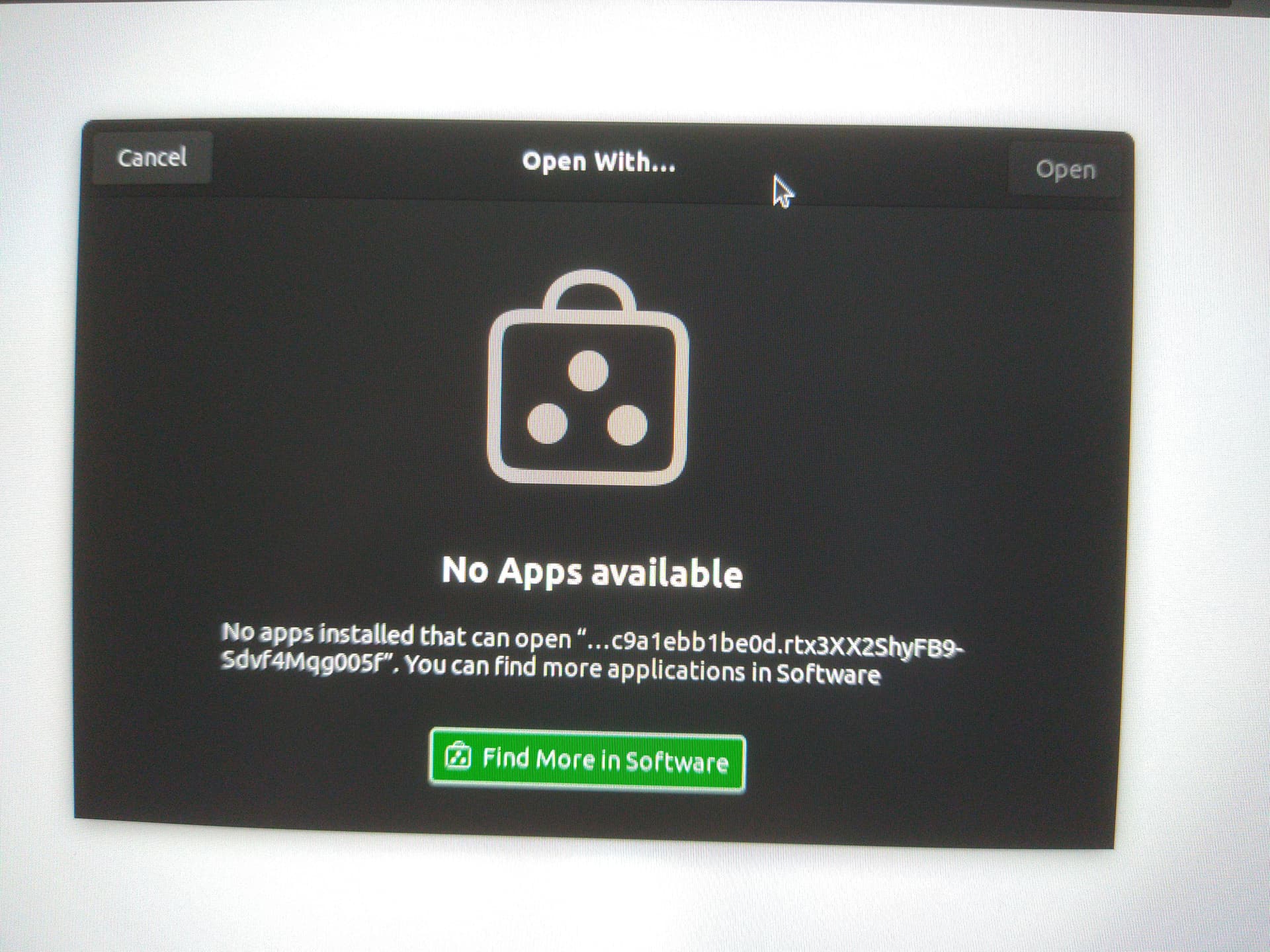

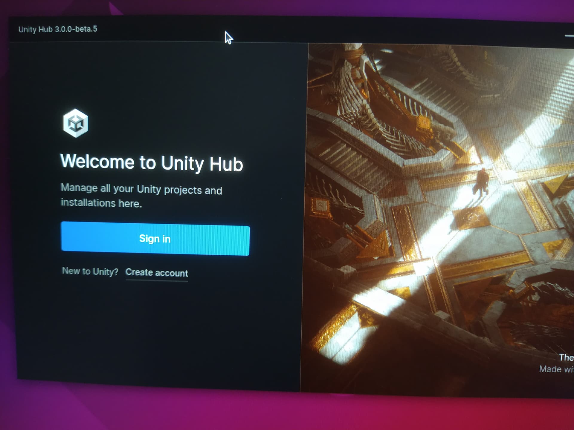

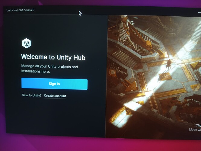

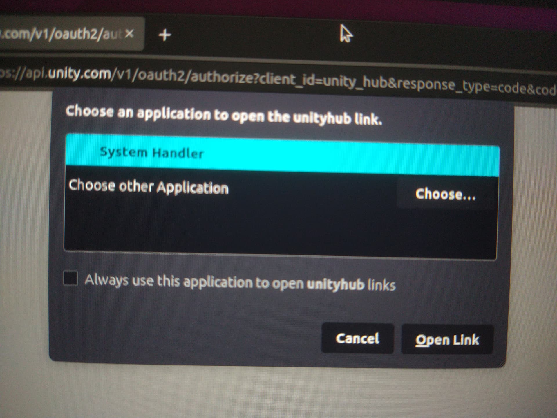

But when I click the Unity Hub Sign In button I get this…
From what I can gather from reading about this, it’s supposed to sign in via a browser… But I’m not 100% sure about that
You are correct. The sign-in links are browser by default, so you can select whichever browser you have as your preferred one when it asks you to choose another application. :slight_smile:
