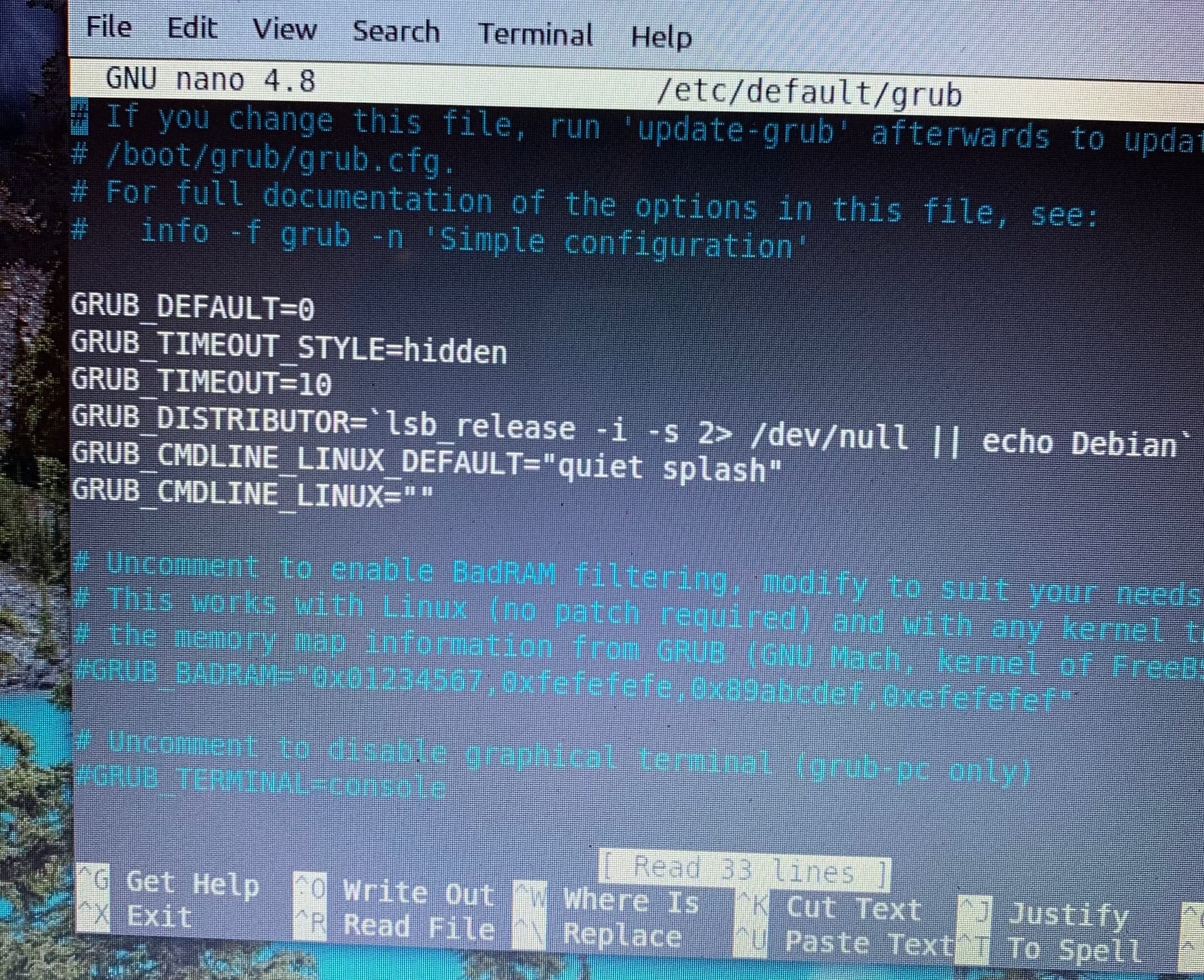

I’m having similar issues with my MBP. Installed Mint, updated, upgraded and rebooted. All good. Installed Ubuntu and after that I get no grub menu and only boots to Ubuntu. I tried all the above including update-grub. Still no grub on boot. Reinstalled Mint (Replaced) and now no grub and only boots to Mint. Thinking I’ve forgotten something basic about Macs. I’ve had dual boot on this computer before with no problem. I have quad boot on the HP laptop and runs flawlessly with full list in grub every bootup. I tried the above from terminal in Mint with the same results.

Thank you for that. Except still no grub. However for timeout I have =10 which shouldn’t be a problem. In fact, when grub should be displayed there is a 10 second pause with nothing but a solid cursor. Then boots to Mint. I’ll send a snapshot of the nano screen.
I was able to arrow down twice and hit enter during the 10 second pause, still blank screen, then it booted to Ubuntu instead of Mint. Seems its there but still hidden.
“quiet_splash” ?
If I comment out that line, what happens?
I’ll answer that. Still no grub but displays the boot and shutdown.
Hey @GrillerMiller!
Do you have OS-Prober installed? Also, for it to work, there’s usually a commented line at the very end. Were you able to check that out?
