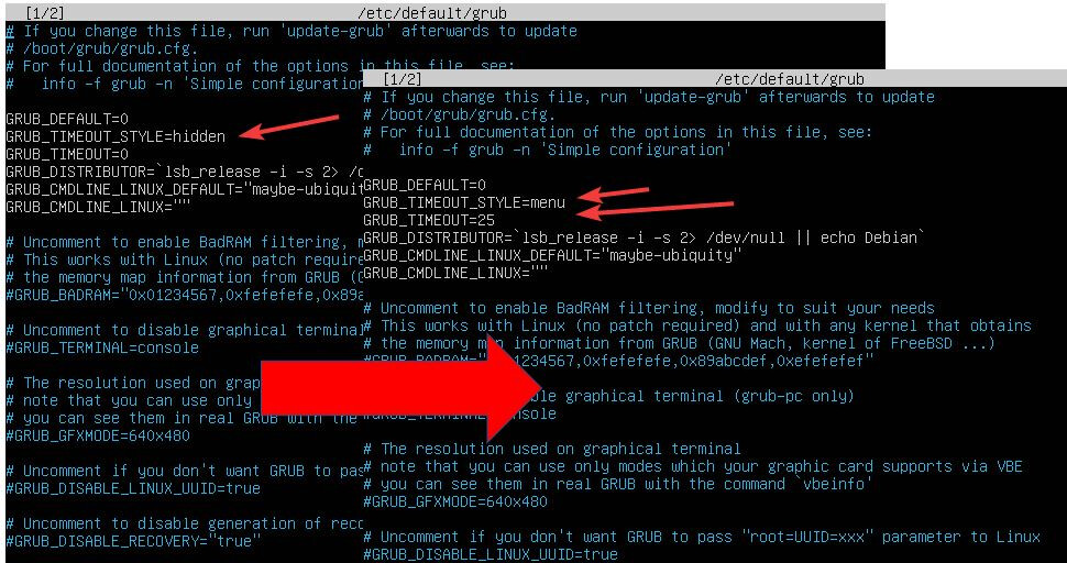

Change the GRUB_TIMEOUT_STYLE and GRUB_TIMEOUT as shown in the picture below:
Once you perform the changes, hit CTRL+O then Enter to save it. And CTRL+X to exit.
Note: You can set a different countdown timer, like 5 or 10 (it’s in seconds).
