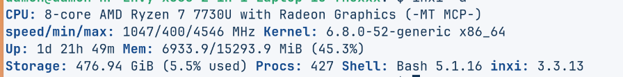

What Kernel are you running now?
And what repository are you getting your updates from?
6.8.0-52-generic

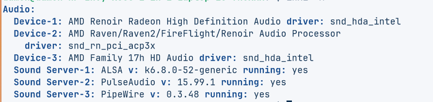

Can you run this command and post the result?
inxi -A

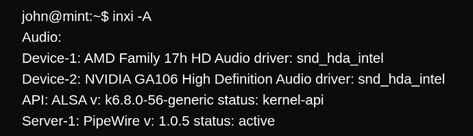

Please add the “-A” argument to inxi, per Phobos’s suggestion. The -A argument lists the audio device(s):
john@mint:~$ inxi -A
Audio:
Device-1: AMD Family 17h HD Audio driver: snd_hda_intel
Device-2: NVIDIA GA106 High Definition Audio driver: snd_hda_intel
API: ALSA v: k6.8.0-56-generic status: kernel-api
Server-1: PipeWire v: 1.0.5 status: active

I notice that you are running 3 sound servers.
Alsa, PulseAudio and Pipewire.
It may be worth a try uninstalling PulseAudio and let Pipewire take up the slack… so to speak. I would do a reboot after uninstalling Pulse.
