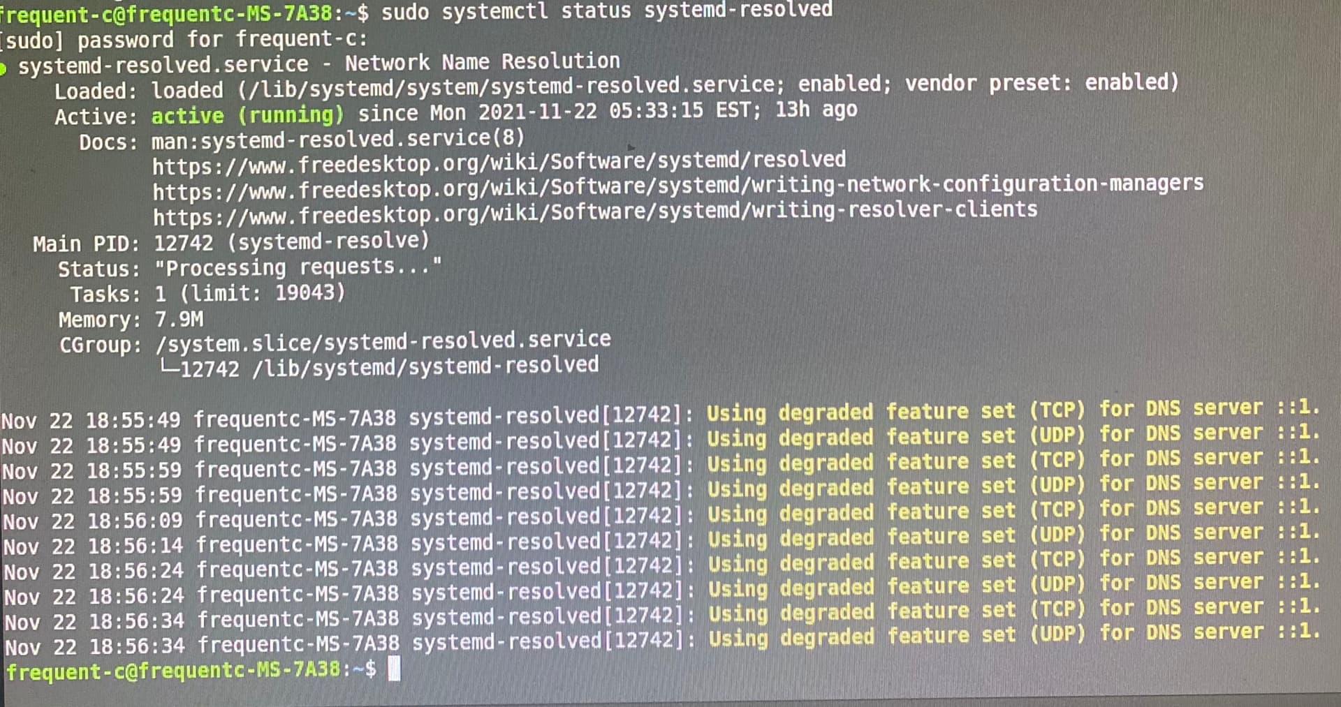

In your terminal, please execute the following command and send me the output.
sudo systemctl status systemd-resolved
And there lies your problem! Your system looks for a DNS resolution onto its own self.

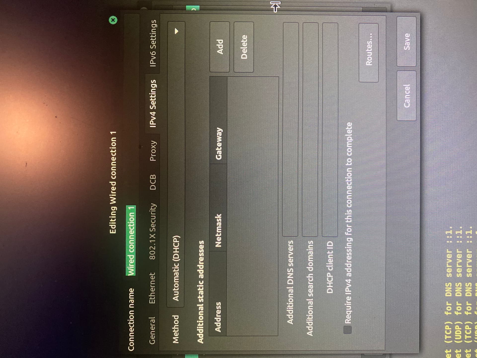

Can you open up your network connections and select the properties for your connection? There should be a few tabs over there and I will appreciate if you can send me the screenshots of your IPV4 and IPV6 tabs.
Great, thank you!
I would recommend you disable the IPV6 completely, and then on the IPV4, add the following additional Name Servers:
1.1.1.1, 1.0.0.1
Then click Save, go to a terminal and type in:
sudo systemctl restart NetworkManager
Then execute:
ping -c 3 google.com
And let’s see what that now gives you.
it doesnt give me the option to click save no matter how i type the 1.1.1.1 or the 1.0.0.1, am i doing this correctly? i have disable the IPv6 settings also.
Not the IP addresses. Use those for the Additional DNS servers.
(Make sure you delete the static IPs or you won’t have internet at all)
