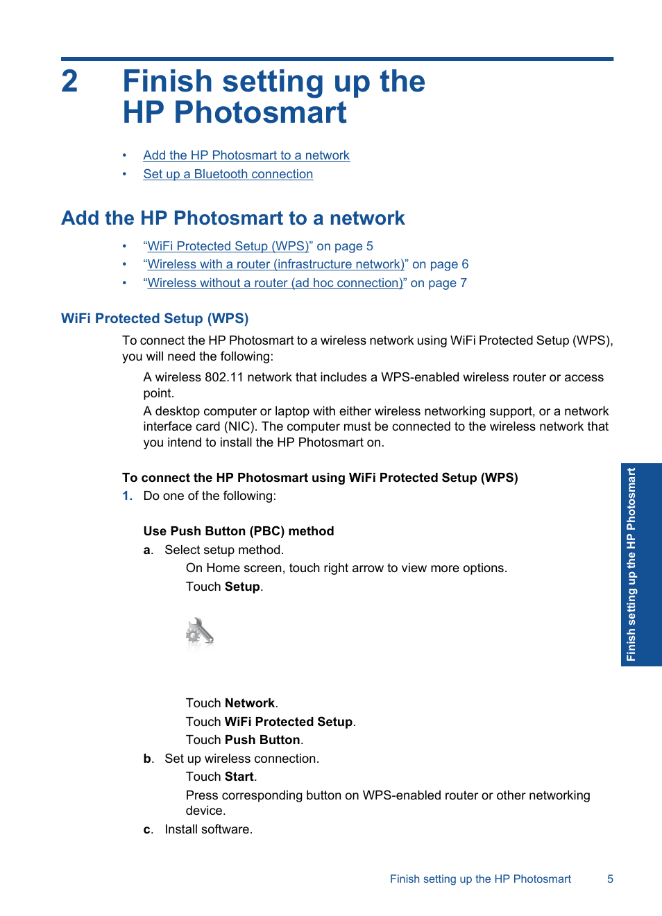

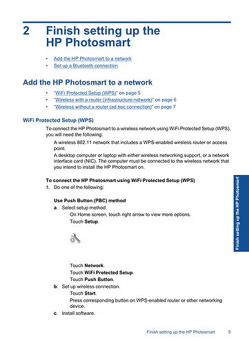

I looked at the HP website for your manual but the HP link to your manual does not work. I found your manual at the following link:
(You can read through the manual and/or download it from the site below but it is windows specific. If you read the sections related to using your router, printer and computer then it may give you more insight into what you need to do in Linux)
If the HPLIP software does not get it set up correctly you can use the system 'Printer Add" that you have used before to add the wireless printer and during the process you will select the hplip printer driver for your printer.
