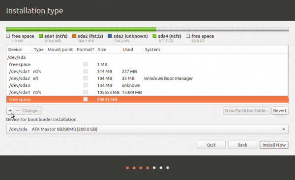

Found this. Was helpful for abbreviations.

The partitioning thing remains a mystery to me. Not the concept, but the abbreviations and visual representations are not self-evident. I just need to see many screenshots and a written description of what it means.
I may just do a complete reinstall and erase my HD because I have no idea what the horizontal line means and where the data is. I want to merge it all and create a new partition for my home folder. I know just enough to be dangerous! :smile:
