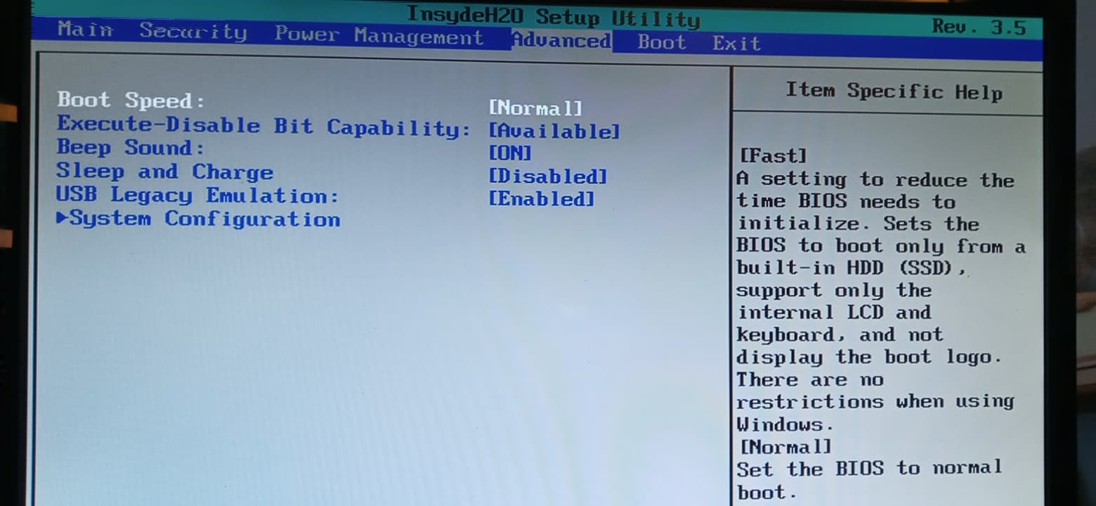

Hey @Minty,
Thank you @mva for your input on this thread! I was hoping it would get resolved thus far, but it would appear that the Toshiba is a bit stubborn.
First, I would retry Rufus with Zorin. This time, I would recommend the recording to be done in DD mode rather than ISO. This tends to fix a lot of boot-up issues, as I’ve personally experienced.
Second, if you have Windows 7, your system should have the UEFI, which includes the Secure Boot. In some scenarios, one needs to set an Administrator/Supervisor password for the UEFI to full activate its options and allow you to disable Secure Boot (and delete the keys). Though I believe this to be somewhat secondary for the moment.
Since your USB worked on another system, then this means it’s a boot-loader issue.
Can you upload a few photos (just drag and drop them on the text window of your response) of your BIOS so that I can get a clear view of what it allows you to do and what it does not?

Thank you for sending those, John!
Your system is indeed a 64-bit. And the changes you did in the end are good. The USB should be first in line for it to boot.
Please let me know how it goes.
