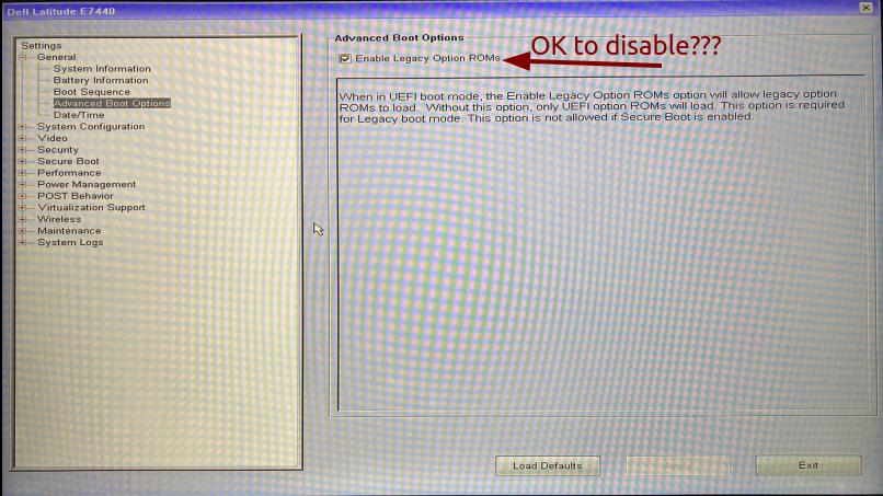

Questions:
Is it ok to disable the Boot Option, “Legacy Option ROMs”? What are the repercussions of disabling it?

Thank you for the screenshots, @nwarren!
You’ve encountered one of the most common issues! Legacy vs UEFI. The short answer is yes, disable both Legacy and Secure Boot so that your booting parameters revert to the EFI filesystem approach.
The automatic version also detects if the BIOS has Secure Boot on or off, so you don’t need to go into the advanced settings. And you are correct, it’s always best to have SB off!

Disabling “Legacy Boot” requires two steps…and in a specific sequence.
- When UEFI is enabled, all the former Boot Sequence options change. I needed to manually reposition USB as 1st to boot.
4. ONLY THEN was I able to disable Legacy Options ROMs.
When I attempted to disable Legacy Options ROMs first, I got this error:
