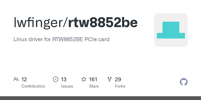

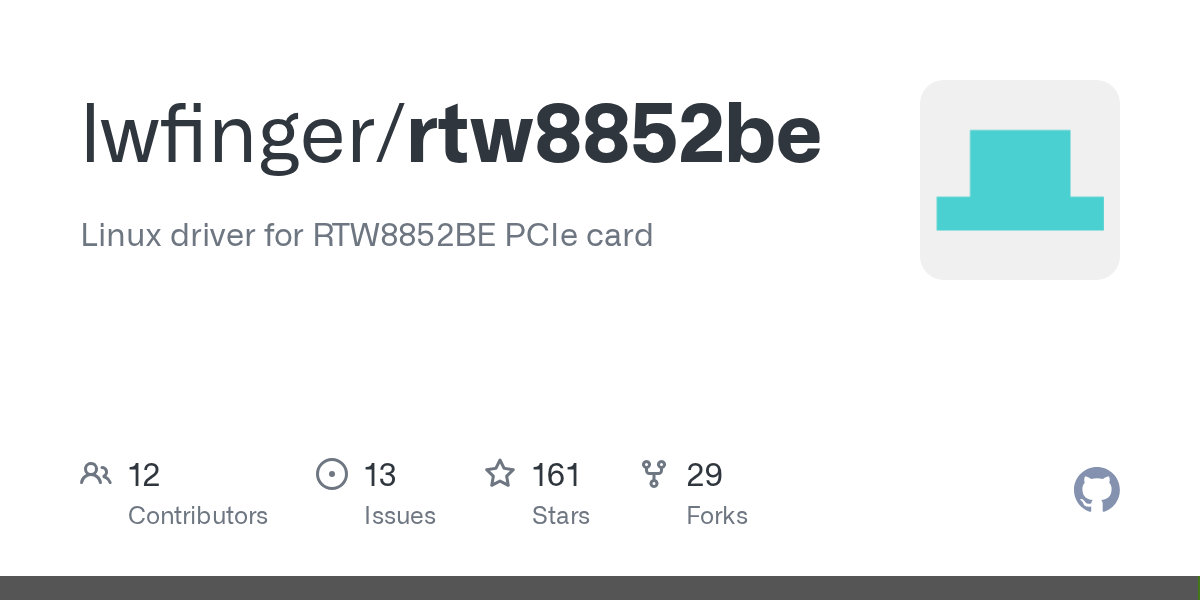

This first link is an abbreviated set of commands, at the very bottom, to compile and insert the module needed for your Realtek Device b852. Note the instructions are for Ubuntu so will need to be modified to work with Fedora’s dnf and you would need to be sure the kernel-headers and development tools are installed as in the second link.
This, second link, is a git repository of the module you will need to compile and insert to allow your wifi device to work. Please read through this and take note of the Fedora requirements as well as all distros requirements.

From this link that you provided:
https://github.com/lwfinger/rtw8852be
After making sure all of the packages were installed, I simply did the following from my user terminal:
$ git clone https://github.com/lwfinger/rtw8852be.git
$ cd rtw8852be
$ make
$ sudo make sign-install
(note: if secureboot was not enabled it would be sudo make install)
