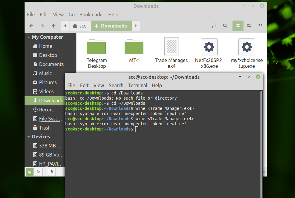

I’d recommend you download your exe file into your Downloads folder and then open up a terminal. On it, type:
cd ~/Downloads
wine <name_of_file>
And replace the “<name_of_file>” with the actual exe file you have. Does it give you any feedback?

Hi @vasileios ! I was able to find the correct folder/method to download the program. The issue was a simple locating of the program file in Crossover then locating the data folder of Metatrader 4.
