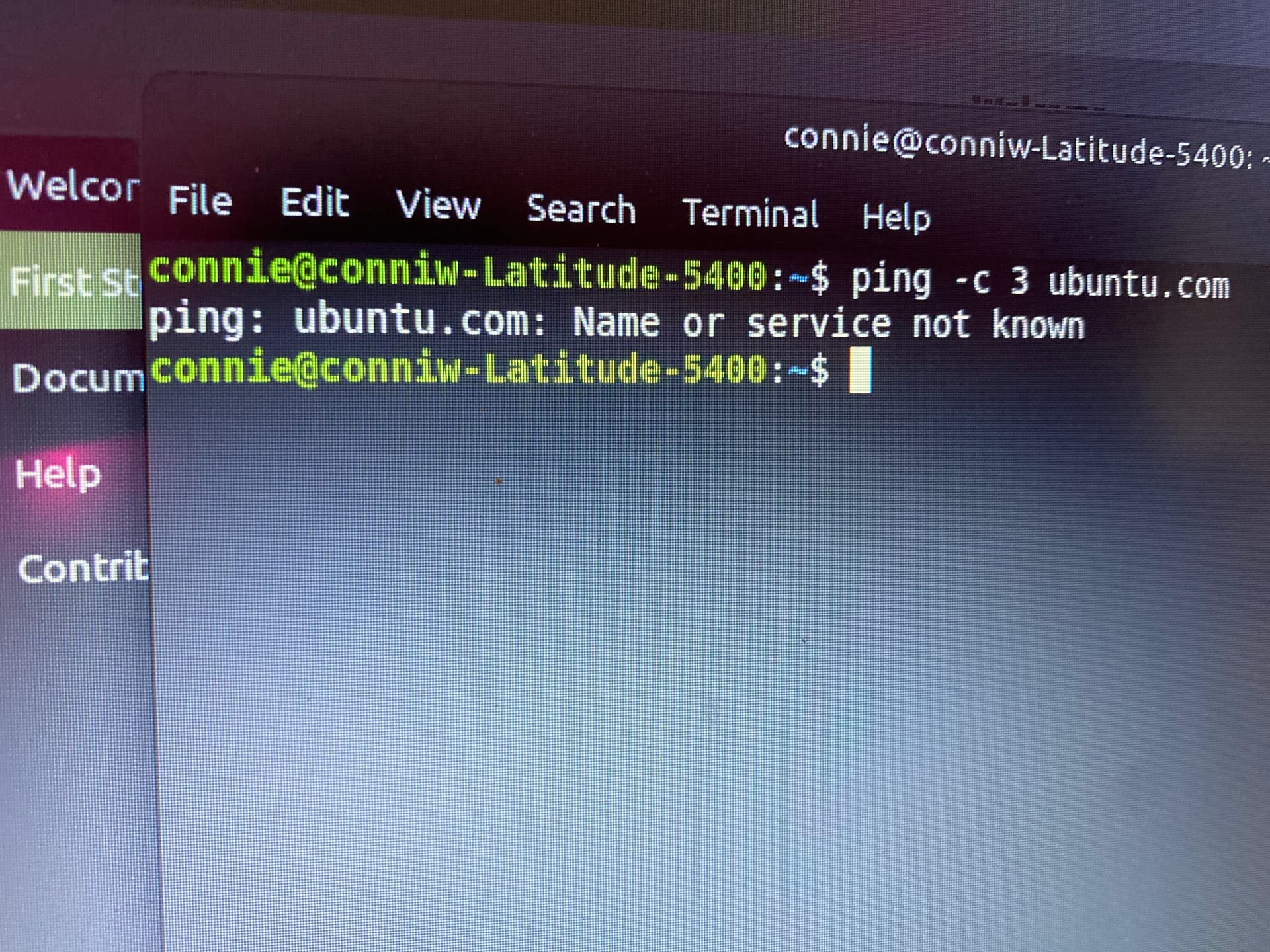

from a terminal run:
ping -c 3 ubuntu.com To check connectivity
Missed this part, we will first then have to get that solved.
