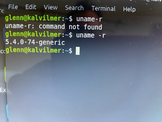

You’re doing it right. Can you open up a terminal and type in the following command?
uname -r
And please let me know the result. I remember Mint comes with the 5.4 Kernel, so I want to be certain that it’s still on that number. :slight_smile:
This is what happened
As I thought! Your issue could be the older kernel not having all the drivers. I have two recommendations, if you don’t mind testing them out. :slight_smile:
