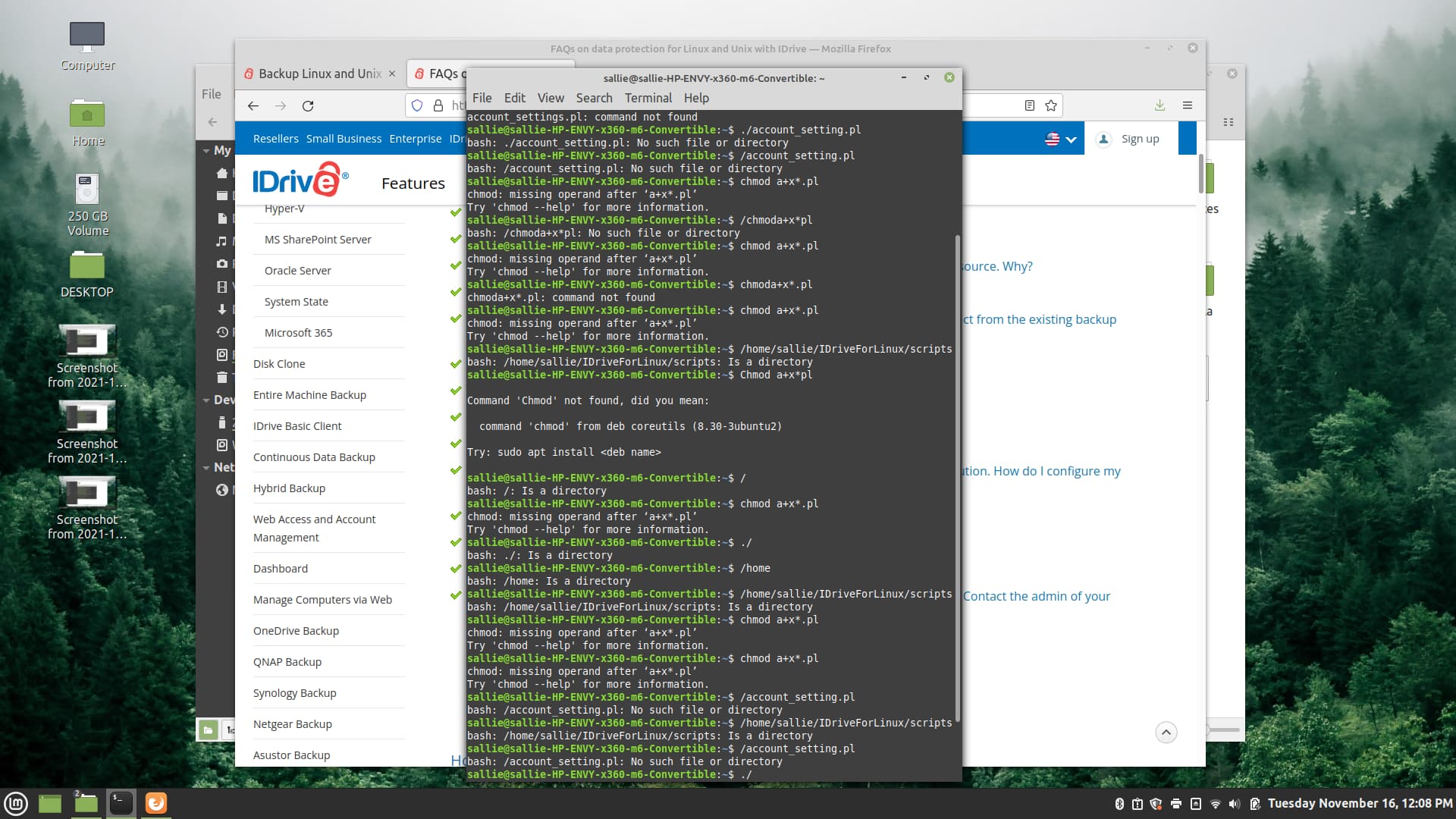

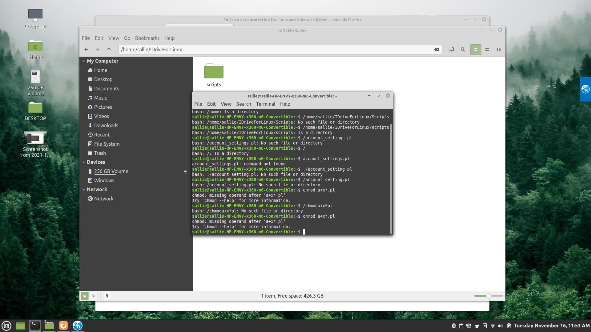

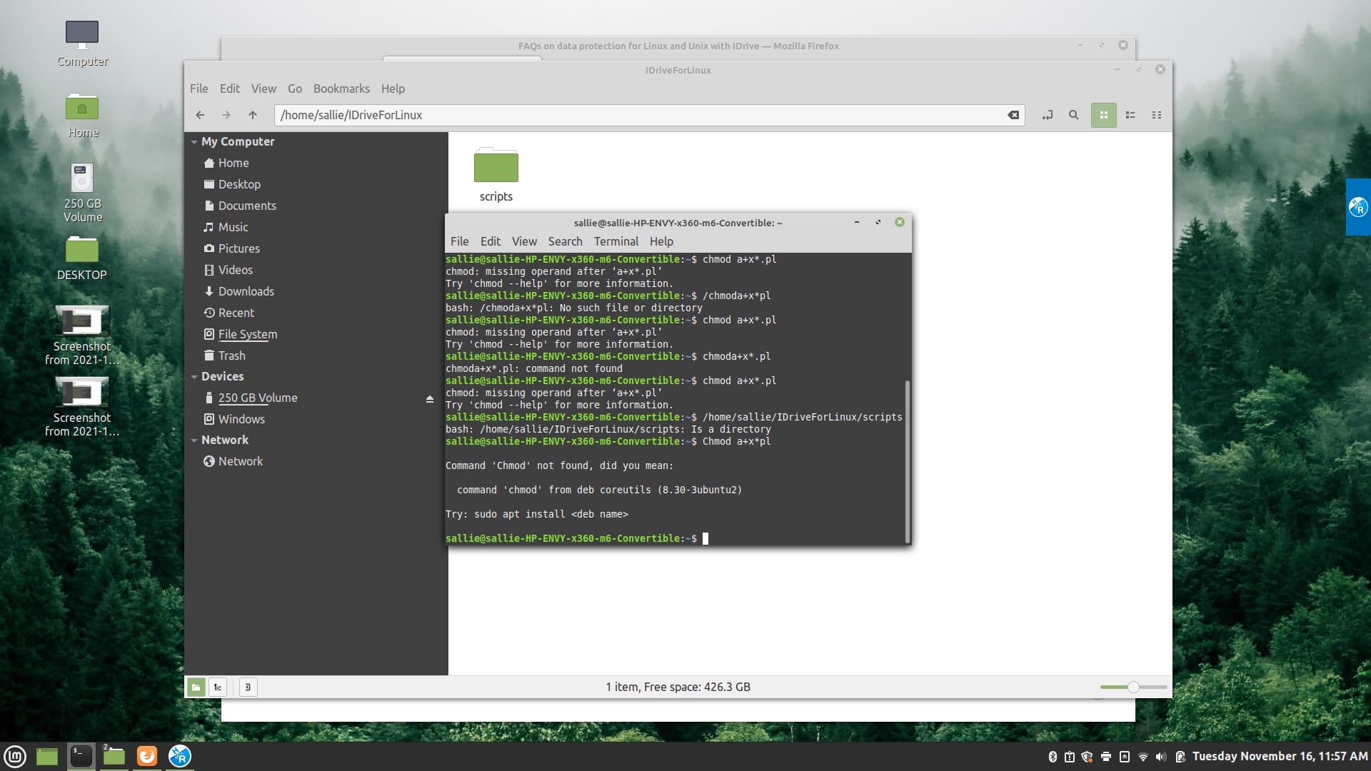

Follow up: I just had a remote control session with an iDrive tech. He worked in the terminal and could verify that directories exist, and tried to chmod the permissions per their directions but it wasn’t working. He also looked for the script files by the terminal but they were saying they weren’t there. Odd. They are there. You can see the window with the path to the files in the attached screen shots. This can give you an idea of what’s being tried.
You can see that when he tried to verify the folders in the tree that he got “Is a Directory” replies. But when I tried to locate a file in the “scripts” folder, there was “no such file or directory”.
Being new to the terminal in Linux, does anyone see a problem here with this? Yesterday I had a couple other situations where I was trying to run a command and got “no such file or directory” (can’t remember at the moment what the files were I was trying to accomplish, so no specific examples). Is this an error with Linux that is remedied or is there something that I should look into?
I’ve had no problem running some other commands, so this is not a “terminal is broke” thing or something.

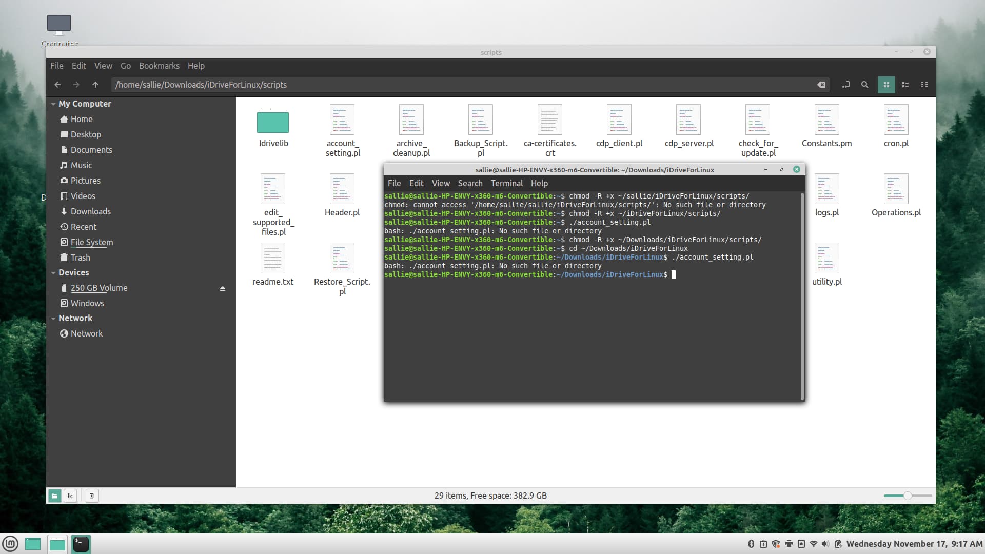

Here is a screen shot of my process.
I first tried to chmod the path I saw in the File manager, with “sallie” in the path. This had an error, so I tried just the iDrive folder and scripts and that didn’t take. Then I moved the folder into Downloads and tried the path you suggested. I didn’t get a bash message with no such file or directory. I assumed this was good.
Then I did the cd ~/Downloads/iDriveForLinux which you gave. I got a blue response that I assume was “you’re in now”. Next was to run the account_setting.pl file which is iDrive’s first script to run. It said no such file. Well you can see in the screen shot that the file is the first one in the window.
So I need your advice again. Thanks!
No worries! I was looking up the script types and I suspect they aren’t executing because you’ll need to install the Perl command set. You can do so by executing - in terminal:
sudo apt update & sudo apt upgrade -y
I placed that in case there are any updates left (so that you don’t have any dependency version mismatches). It will ask you for a password. Go ahead and type it in, even if it’s not visible and press Enter. Then install Perl by typing:
sudo apt install perl
Since you entered your password earlier, it has a timer before it expires, so you won’t get a password request again.
Then you can try to run the scripts. If that fails, then you can simply run (for example the account one) by executing:
perl ./account_setting.pl
While you’re inside the scripts folder. :slight_smile:
