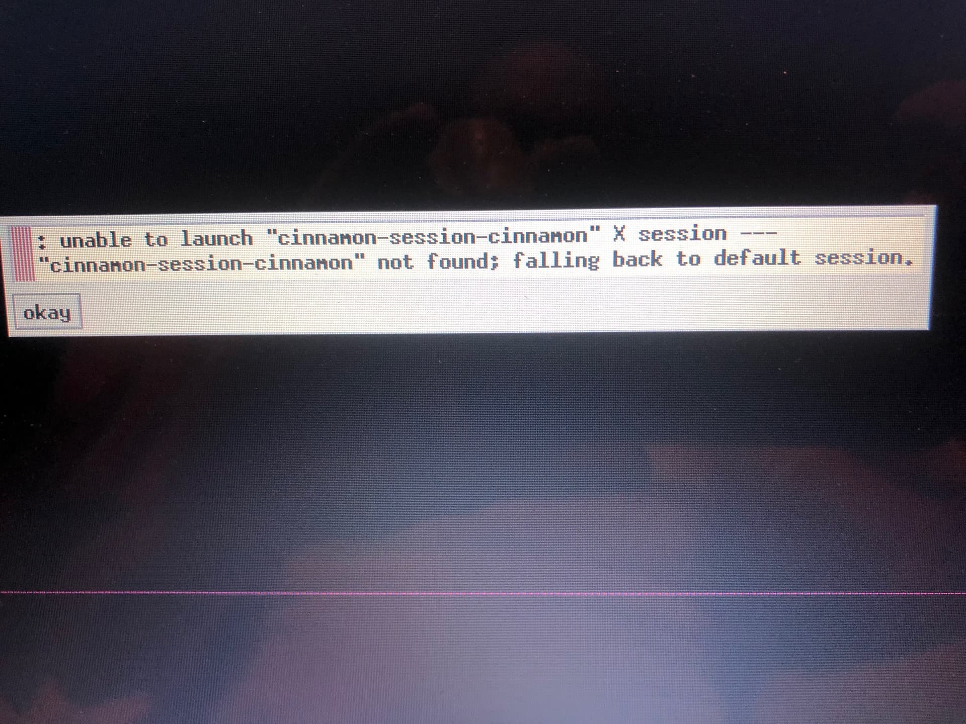

vasileios–Unexpectedly had to boot to windows. When the process booted to Mint, I signed in and received the attached message:
After clicking “okay” on the message, the screen goes blank and nothing happens. Nor can I get a response except only to press the power switch to shut down.
Not sure what’s going on. I’m wondering will I have to re-install Linux, assuming it can be done for this dual-boot setup?
Hey @zpepelepu!
This has occured to another user before, so it’s not unheard of. What you’ll need to do is the following:
When your boot menu (Grub) appears, select “Advanced Options” for your Linux Mint. It will take you to another submenu. Select the Failsafe or Fallback (usually the second option). The system will boot and present you with a window of options. Select to activate the Network and then drop down to Root Terminal (should be the last option). Once in terminal, execute:
apt install --reinstall cinnamon
Then type in:
reboot
And see if that helps.
