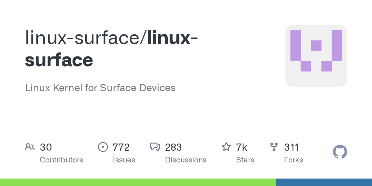

If you wish to install Linux Mint, I would recommend you connect an external keyboard and mouse to go through the installation process. Then, follow the instructions described in the link below, to install and apply the Surface-specific Kernel, which will activate most of your Surface’s hardware.

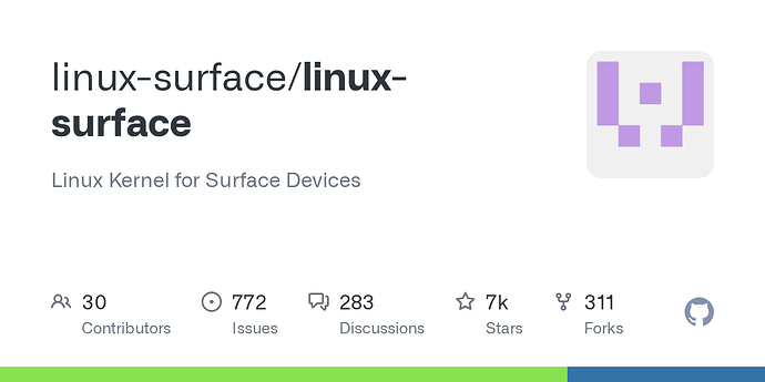

If yes, then nearly all the hardware will work, minus the performance mode, as seen on the feature matrix of the patched kernel below:
I hope this helps!
