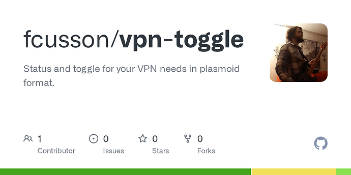

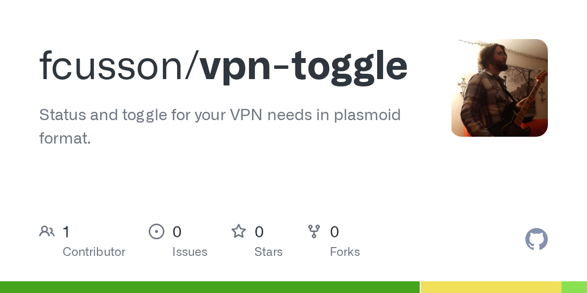

I did find this vpn-toggle that you can install as a widget. It didn’t seem to really do anything, but it was a good exercise in using the command line. I may have missed something.
