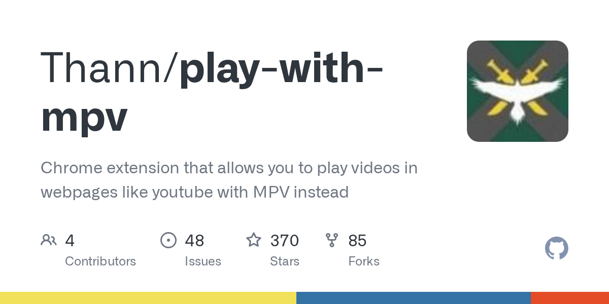

Were you able to visit the GitHub page of the extension? It appears to have extended info on how you can make it function properly.
Yes. I installed the GitHub repository and was able to install it.
