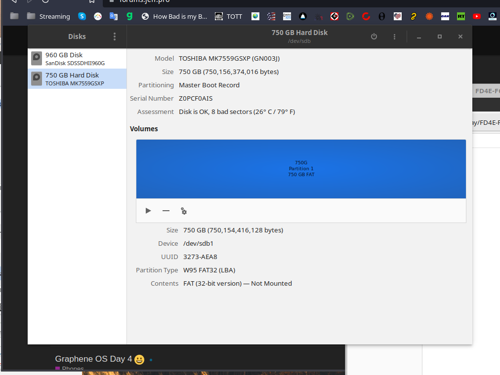

OK thank you. I thought I had formatted the whole disk but I will check it and do it again.
Which somehow still contains Grub (and is FAT32). I’d recommend still formatting it fully to make sure that the boot sector is cleared up.
The system you have that 750GB HD is a single-drive one, correct?
Yes 750GB HD…
