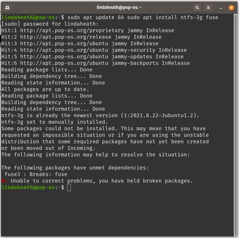

I’m having problems again with my external SSD. I made sure all updates are current. I’m not sure when it happened, but sometime during a session of use, I discovered my SSD was no longer showing (unmounted?) I turned my laptop off for the night. Next day I turned it back on. No change. Made sure all updates were current. Left it alone for a few days. Tried again. Now I’m looking up info. I ran the command above and this is the response:

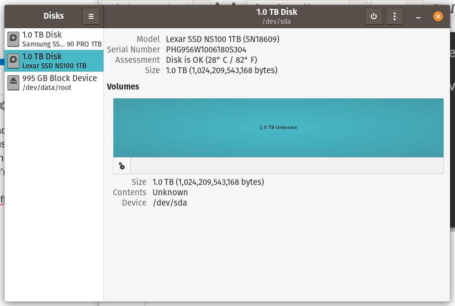

I also looked at the Disks and it shows that it’s plugged in, but that’s about it. There has been zero error message. It just isn’t showing up.

The “Disks” view shows Contents as “Unknown”, that’s strange and may be a concern. Might you have access to a Windows system which you could plug the disk into? If so, plug it in and run a disk check on the drive.

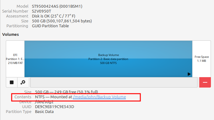

I plugged a windows drive into my linux box and Disks shows this, which I’d expect ( or similar, if the device is formatted with NTFS or EXFAT or DOS ):

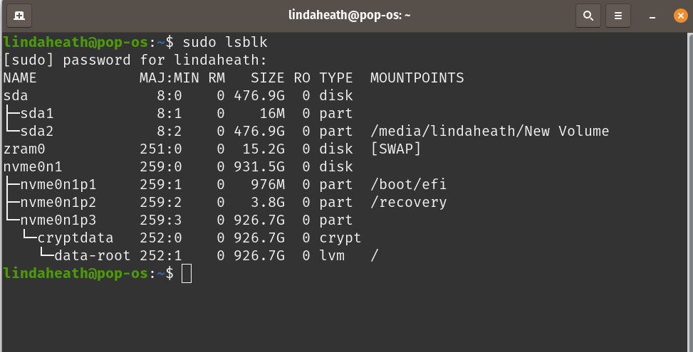

I returned to this thread looking for information (before it fixed itself) and saw this, so I ran lsblk in terminal as suggested. This is what it shows. sda2 is clearly referring to my external hard drive. I’m not sure what the sda1 is referring to. I assume the nvme0n1 is the internal since it’s indicating boot/efi. what is the MAJ:MIN column telling me?
